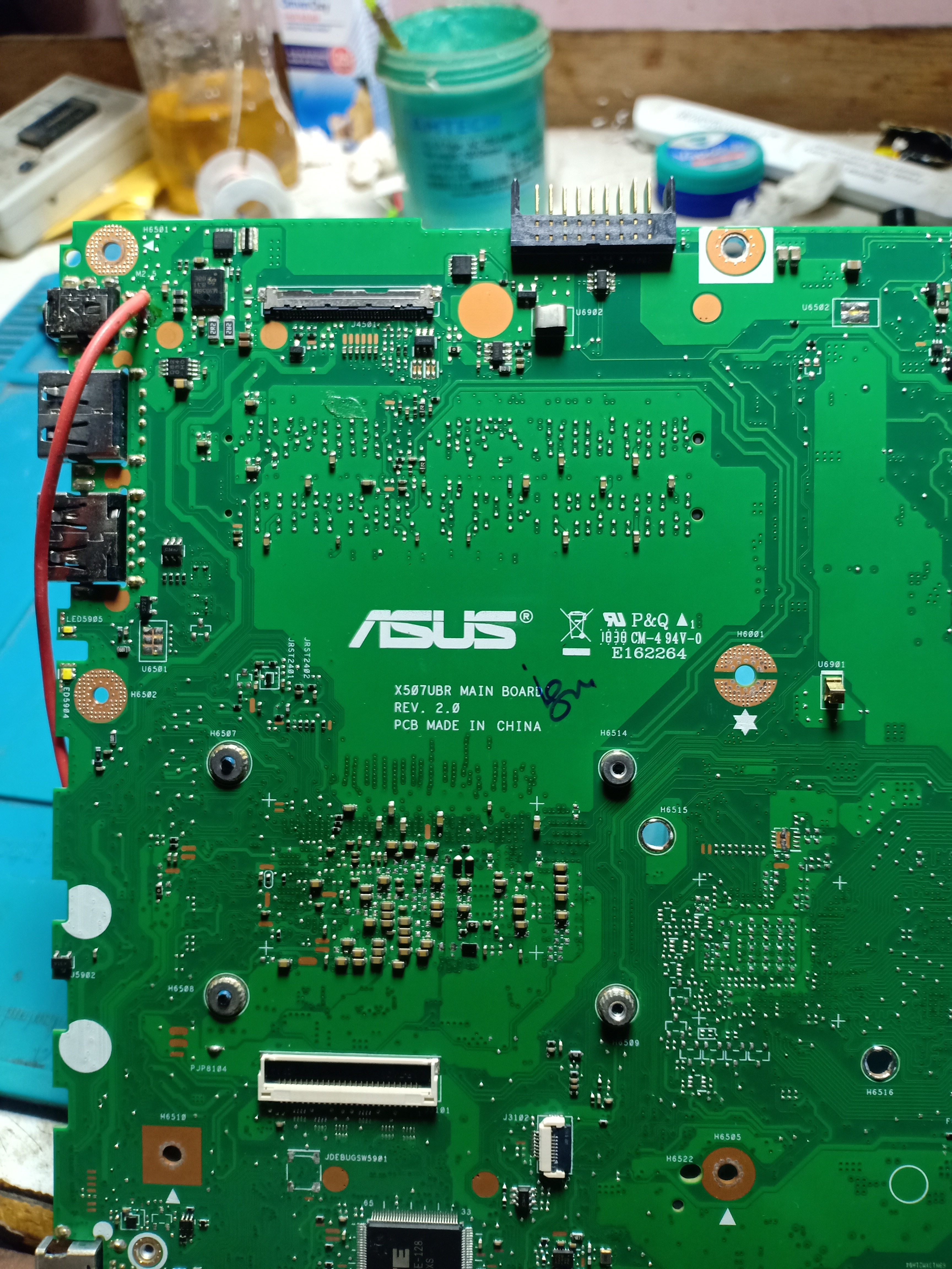

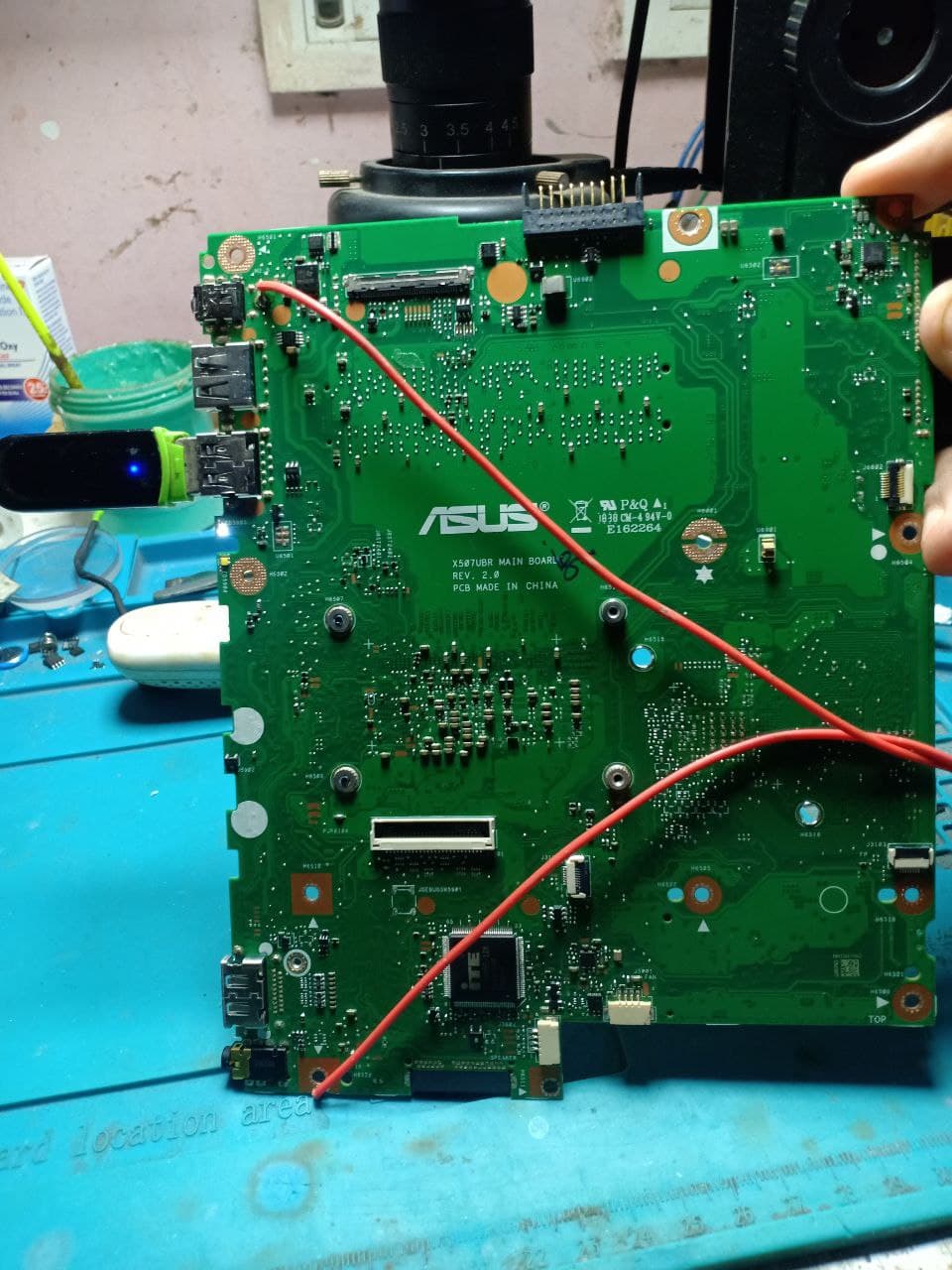

SKB ODM ASUS X507UBT REV 2.0 X507UAR BIOS TESTED DONE

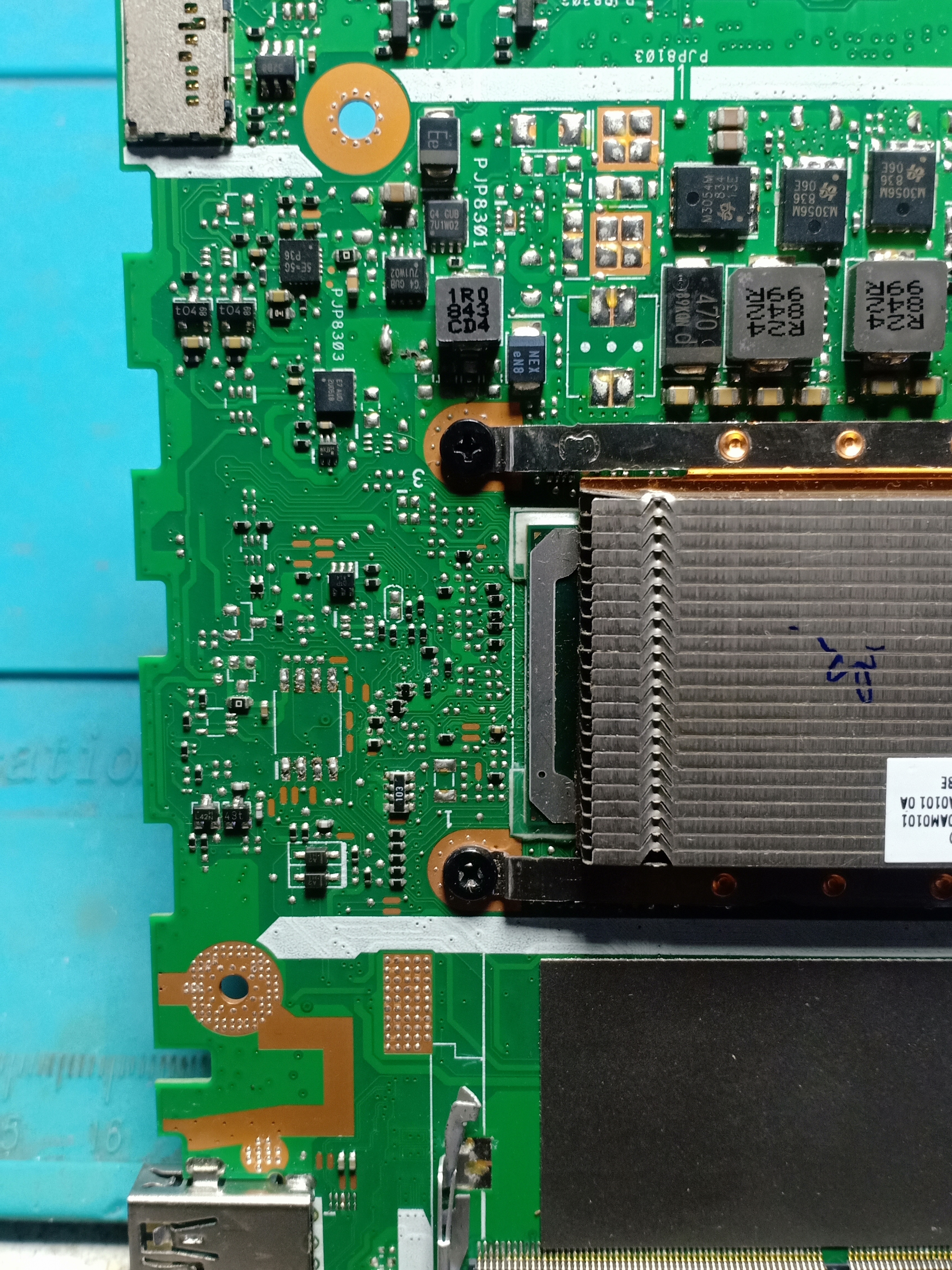

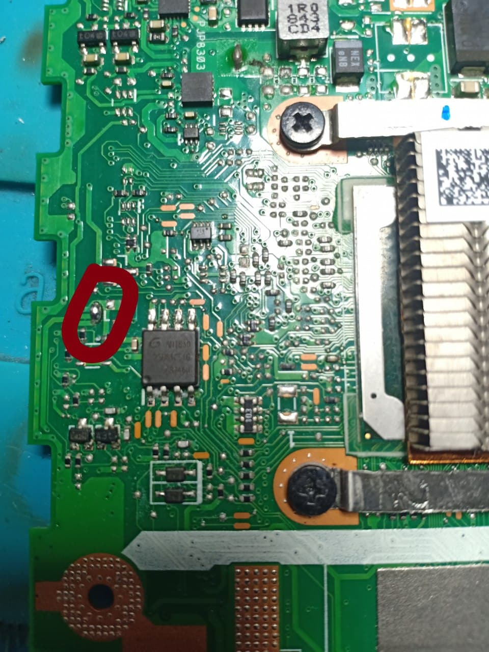

FIX uP1905 CH2 sensor SHORTING ISSUE REGULARLY

01 Fixed the uP1905 IC issue - Disable 1st/2nd uP1905 CH2 sensor.
FIX THE SPI VOLTAGE FOR SUSPEND ERROR NPI
