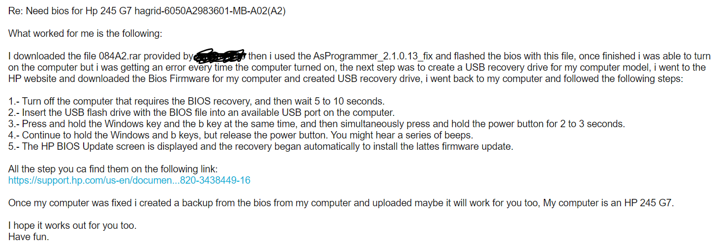

flashed the bios with this file, once finished i was able to turn on the computer but i was getting an error every time the computer turned on, the next step was to create a USB recovery drive for my computer model, i went to the HP website and downloaded the Bios Firmware for my computer and created USB recovery drive, i went back to my computer and followed the following steps:
1.- Turn off the computer that requires the BIOS recovery, and then wait 5 to 10 seconds.
2.- Insert the USB flash drive with the BIOS file into an available USB port on the computer.
3.- Press and hold the Windows key and the b key at the same time, and then simultaneously press and hold the power button for 2 to 3 seconds.
4.- Continue to hold the Windows and b keys, but release the power button. You might hear a series of beeps.
5.- The HP BIOS Update screen is displayed and the recovery began automatically to install the lattes firmware update.
All the step you ca find them on the following link:
https://support.hp.com/us-en/document/i ... 3438449-16
Once my computer was fixed i created a backup from the bios from my computer and uploaded maybe it will work for you too, My computer is an HP 245 G7.
