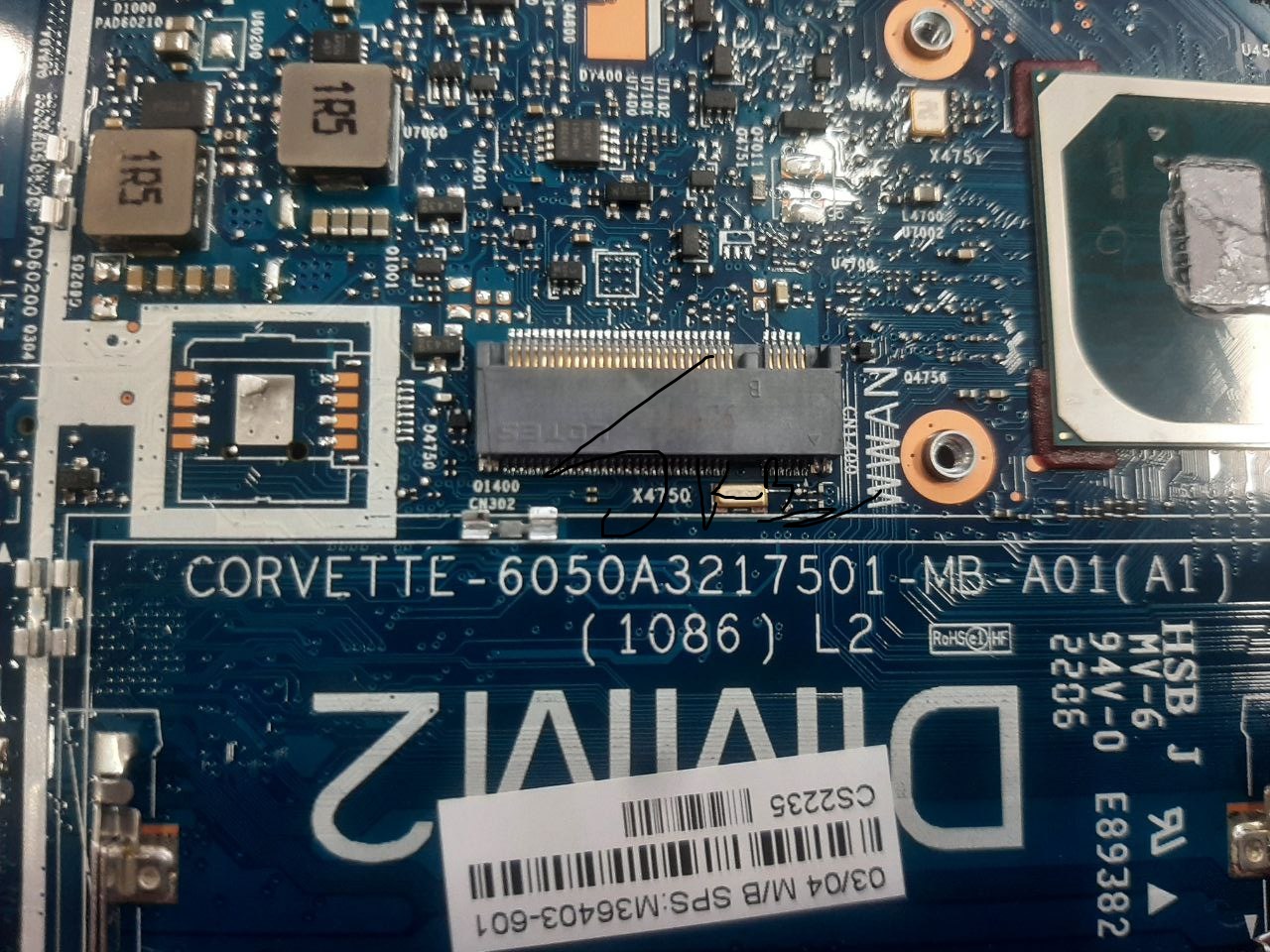

SKB ADL HP ELITEBOOK 840 G8 T76 11th GEN CSME DMI OK END POINT PATCH BIOS LOGO REMOVED CORVETTE 6050A3217501-MB-A01 (A1
SKB ADL HP ELITEBOOK 840 G8 T76 11th GEN CSME DMI OK END POINT PATCH BIOS LOGO REMOVED CORVETTE 6050A3217501-MB-A01 (A1)

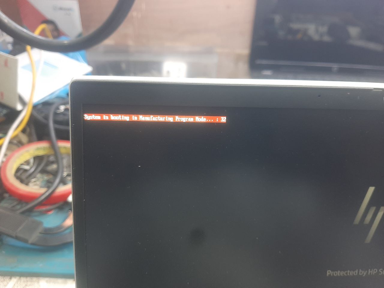

IF END POINT ERROR COME OF DMI BIOS
THEN FLASH ONLY MAIN 32MB END POINT PATCH BIOS
AFTER THIS MPM UNLOCK MASSAGE COME
SIMPLE GO TO BIOS SETUP AND RESTORE SECURTY DEFULT SETTING
SAVE AND EXIT
THEN FLASH AGAIN DMI MAIN BIOS AND ENJOY
