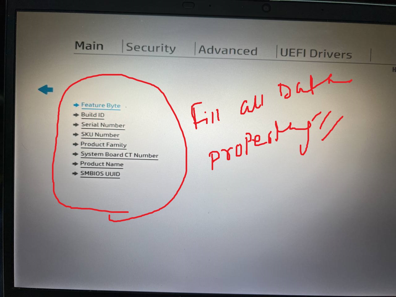

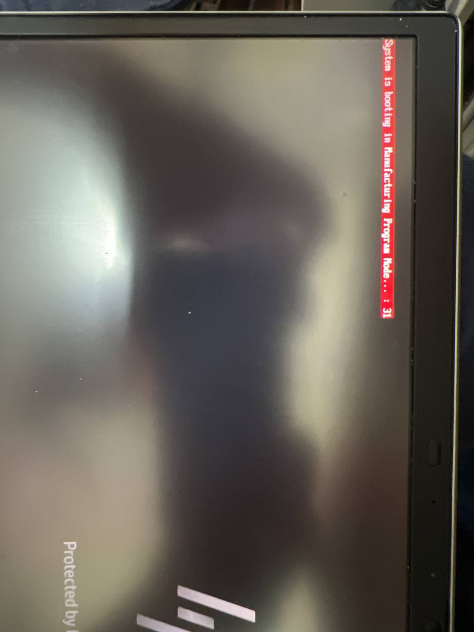

AFTER FLASH THIS BIOS GO TO BIOS SETUP MAIN MENU

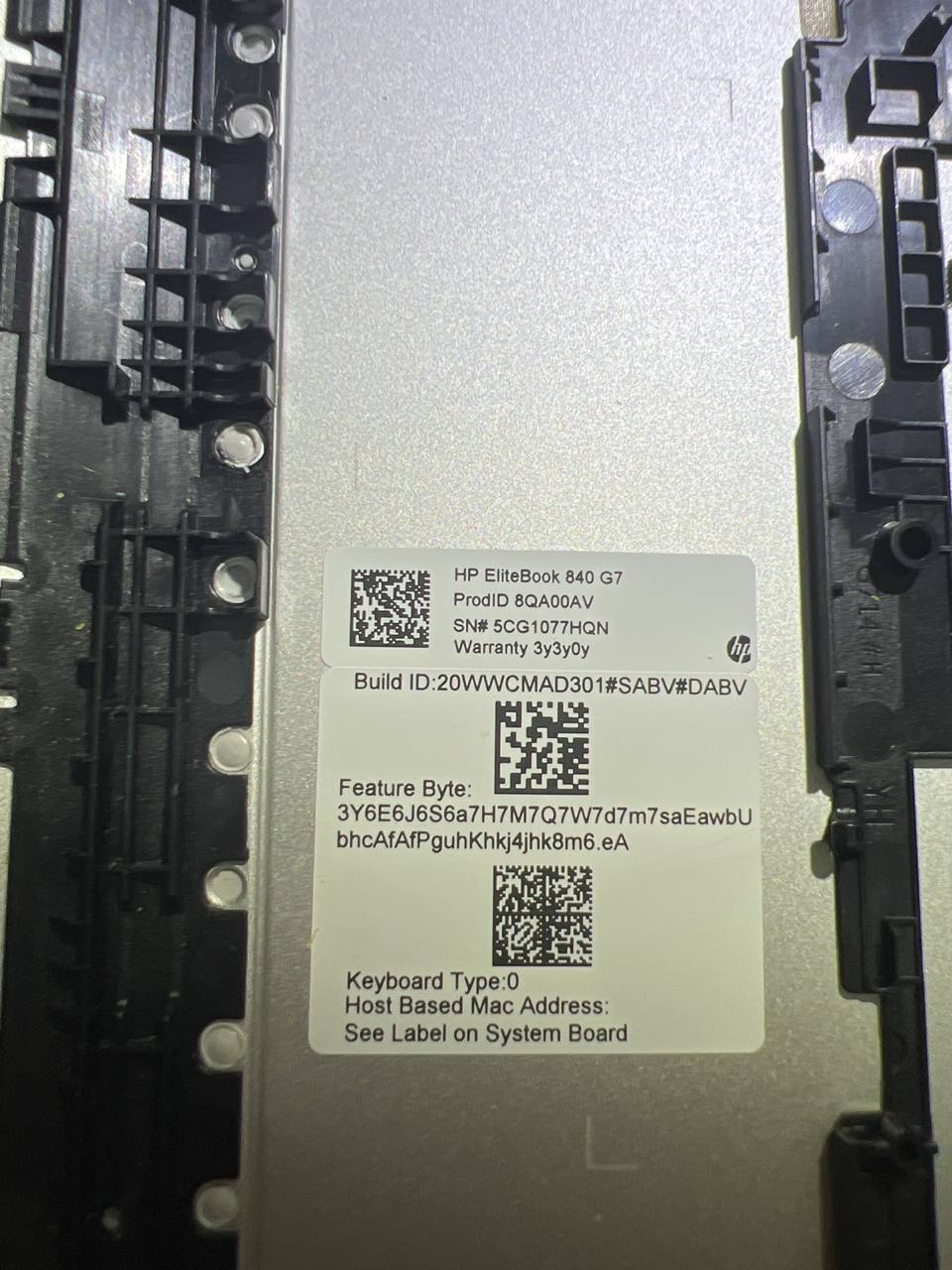

AND SET MACHINE UNIQE DATA & ENTER ALL TYHE INFORMATION FROM STICKER OR OLD BIOS INFO
LIKE SI NUBER , FEAUTER BYTE, MODEL , ETC....
ENTER FEAUTER BYTE SAME AS CAPITAL AND SMALL LETTER
THEN RESTRAT LAPTOP AND FOLLOW THE SCREEN
