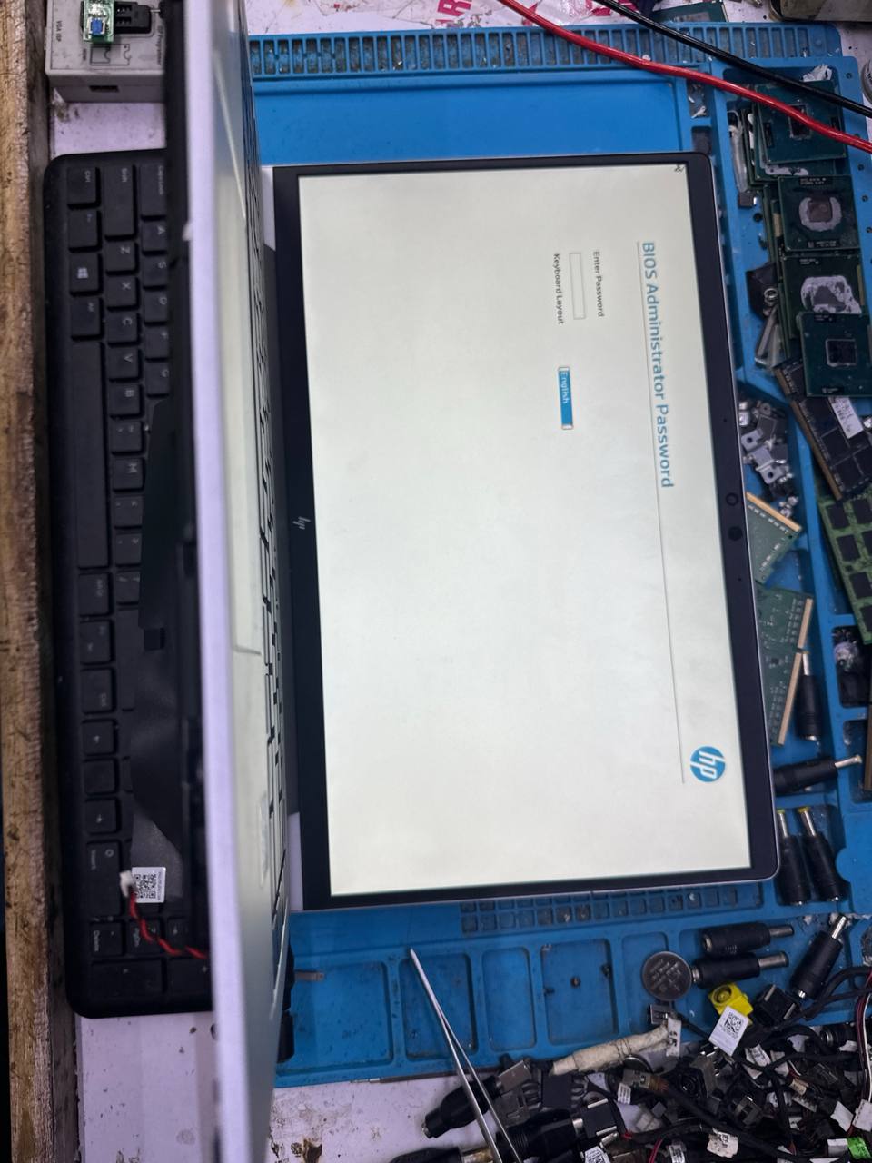

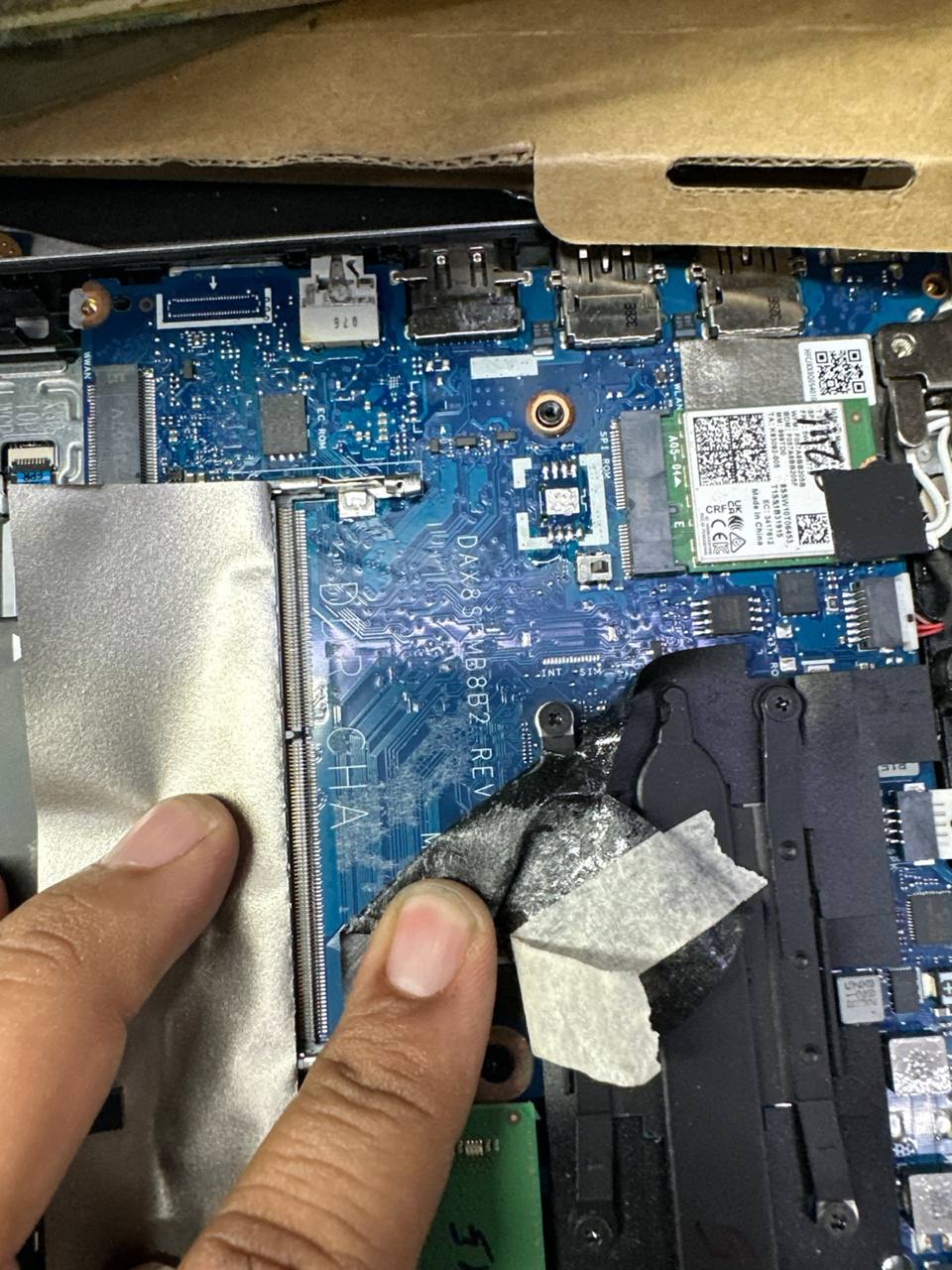

SKB PRO++ HP EliteBook 640 G9 U86 12th GEN CSME CLEAN ADMIN UNLOCK UNIVERSAL BIOS dax8sfmb8b2 ec DAX8SFMB8B2 X8S

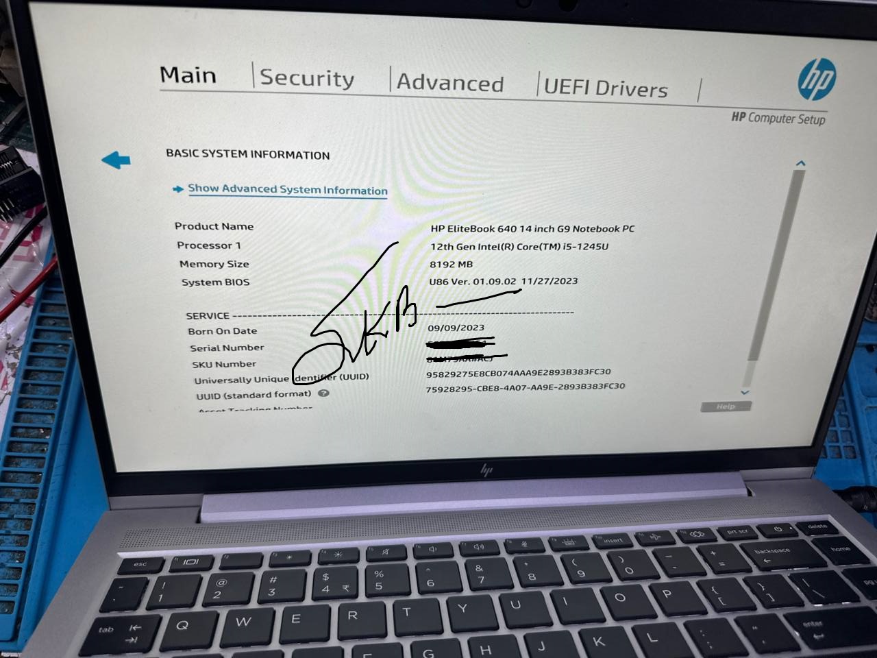

HP EliteBook 640 14 inch G9 Notebook PC
FLSH THE CSME UNLOCK MAIN BIOS
THEN GO TO BIOS SETUP
SET SECURITY DEFULT SETTING
THEN SAVE AND TURN OFF
THEN FLASH UR ORIGINAL OLD LOCKED MAIN BIOS
